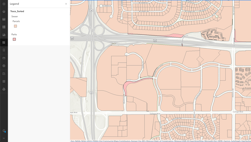

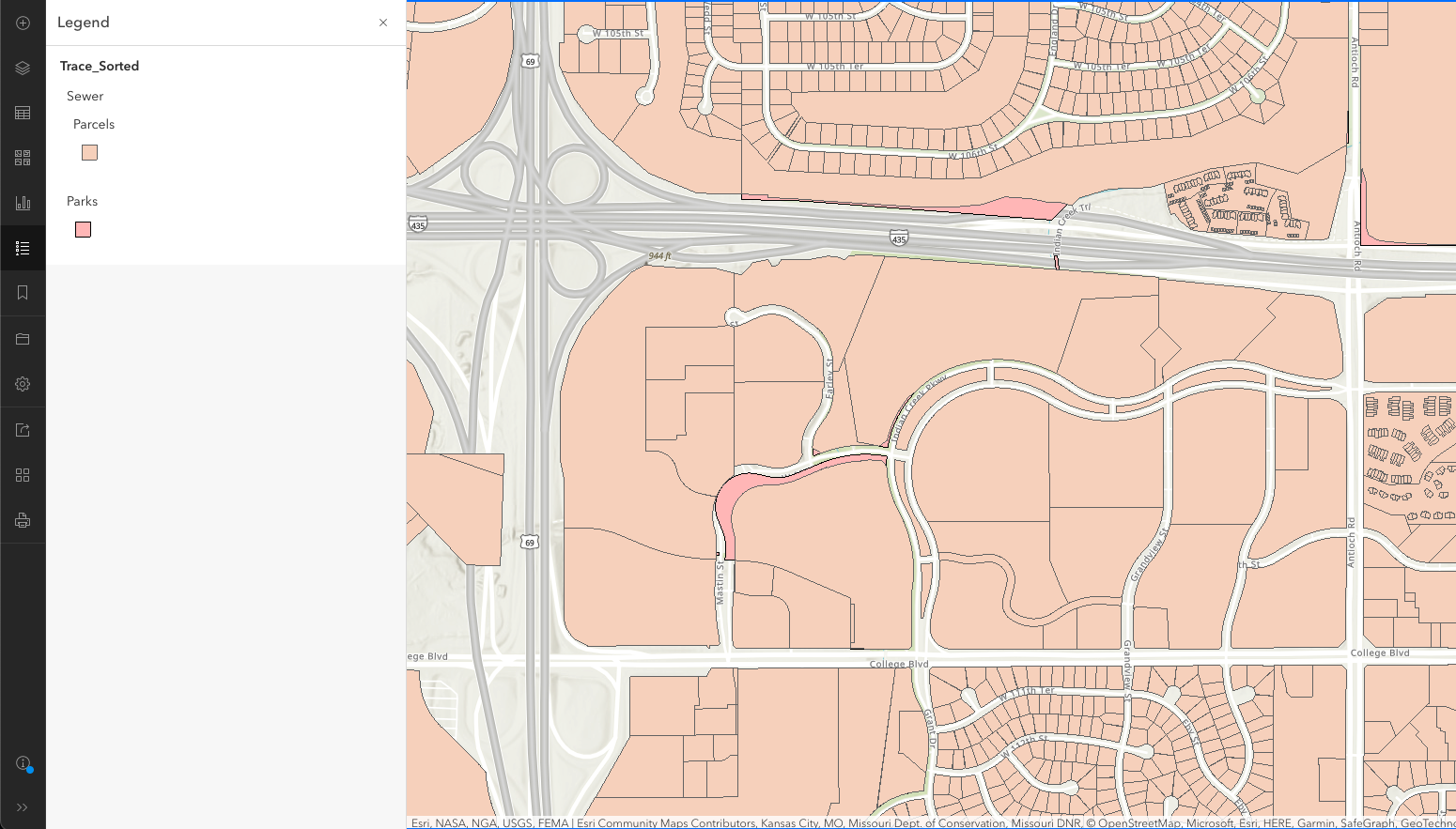

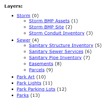

For example, here is the drawing order of a service containing group layers that we published and added to a new Web Map:
Here is how the layers are drawn in the ArcGIS Portal Web Map viewer (it looks the same in our web app that uses the JavaScript API). Notice that Parcels are drawn on top of Parks, as defined in the service:

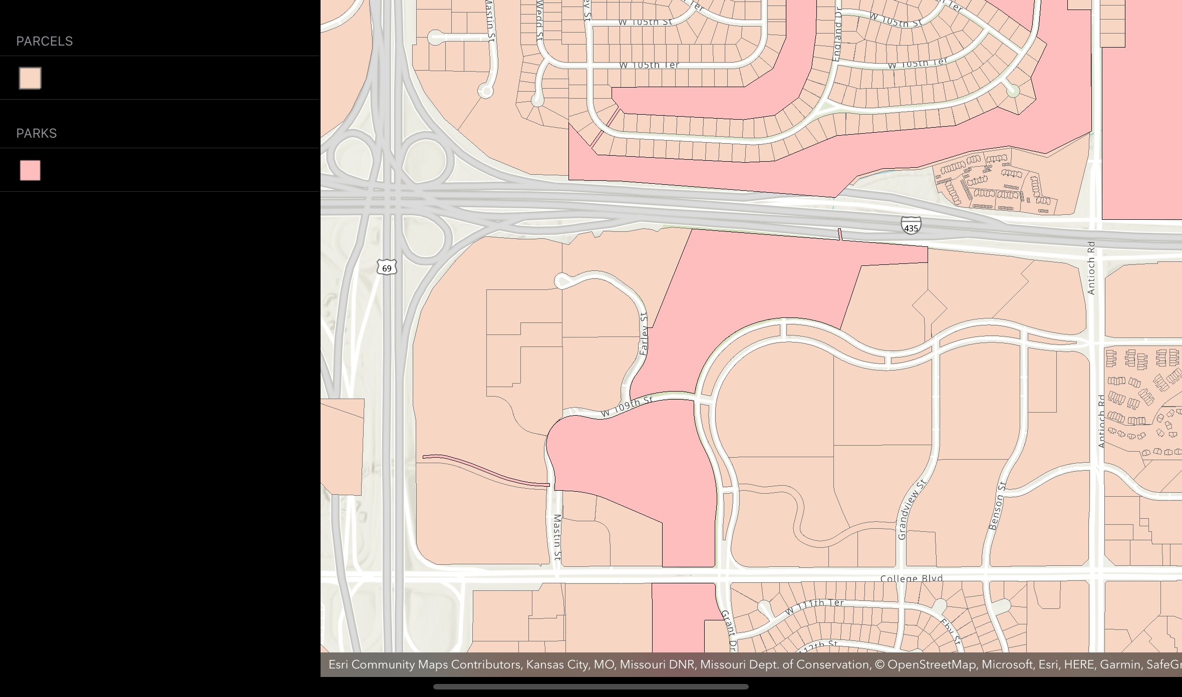

However, in our iOS app that uses the ArcGIS Runtime SDK, Parks are instead drawn on top of Parcels (the same is true in our Android app). Neither app modifies layer drawing order while loading a map:
Is this expected behavior in the ArcGIS Runtime SDKs? If so, is there any way override it?

After messaging with Nick, and further investigation on my end, I have determined the cause of my issue.
Part of my app's loading process for a map involves setting the opacity for each layer based on saved values. It turns out that setting the opacity property on any AGSArcGISMapImageSublayer object (docs here) in my map is triggering the Runtime SDK to redraw the layers.
It's uncertain whether or not this is a bug in the Runtime SDK, but the SDK team is going to look into it. I was able to work around my issue by adding conditions for setting each layer's opacity during map load, instead of setting it automatically.

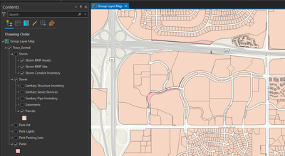

Hi Greg. Thanks for the detailed info. Looks unexpected and could be an issue with group layers.
Are you able to try in ArcGIS Pro and let us know how it renders there please?
Thanks!
Nick.
greg_eam
Hi Nick,
I just opened the map in ArcGIS Pro. Looks like it renders the same as the Portal viewer and JavaScript API:
