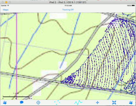

We are Forestry Corporation of New South Wales in Australia. We have a tracking app that records a dozer's locations as points in the background, let's say, in a site preparation operation as an example. The image below shows two recorded operation type points Stacking (green) and Ripping (purple)
Now the operators/contractors are asking converting points to line on the fly. "It's looking like lines from track points from within the app is an important thing. Not so much for harvester tracking but for site prep and roads it seems to be essential. I was thinking that the simplest solution would be to allow the user to build lines from the points within his view extent and delete/rebuild them as required."
I have already tried inserting the points into an AGSSketchGraphicLayer and then grabbing it's resulted line geometry to create a line graphic feature and display the feature on top of the points.
The code is working fine if the number of points is less than 1000 roughly. However, more than 1000 points crash the simulator due to running out of allowed memory. There are totally about 22000 points in the above case.
I think constructing line json from point jsons should be much more efficient and wouldn't require that much memory...
Thanks a lot for your help.
Shimin
