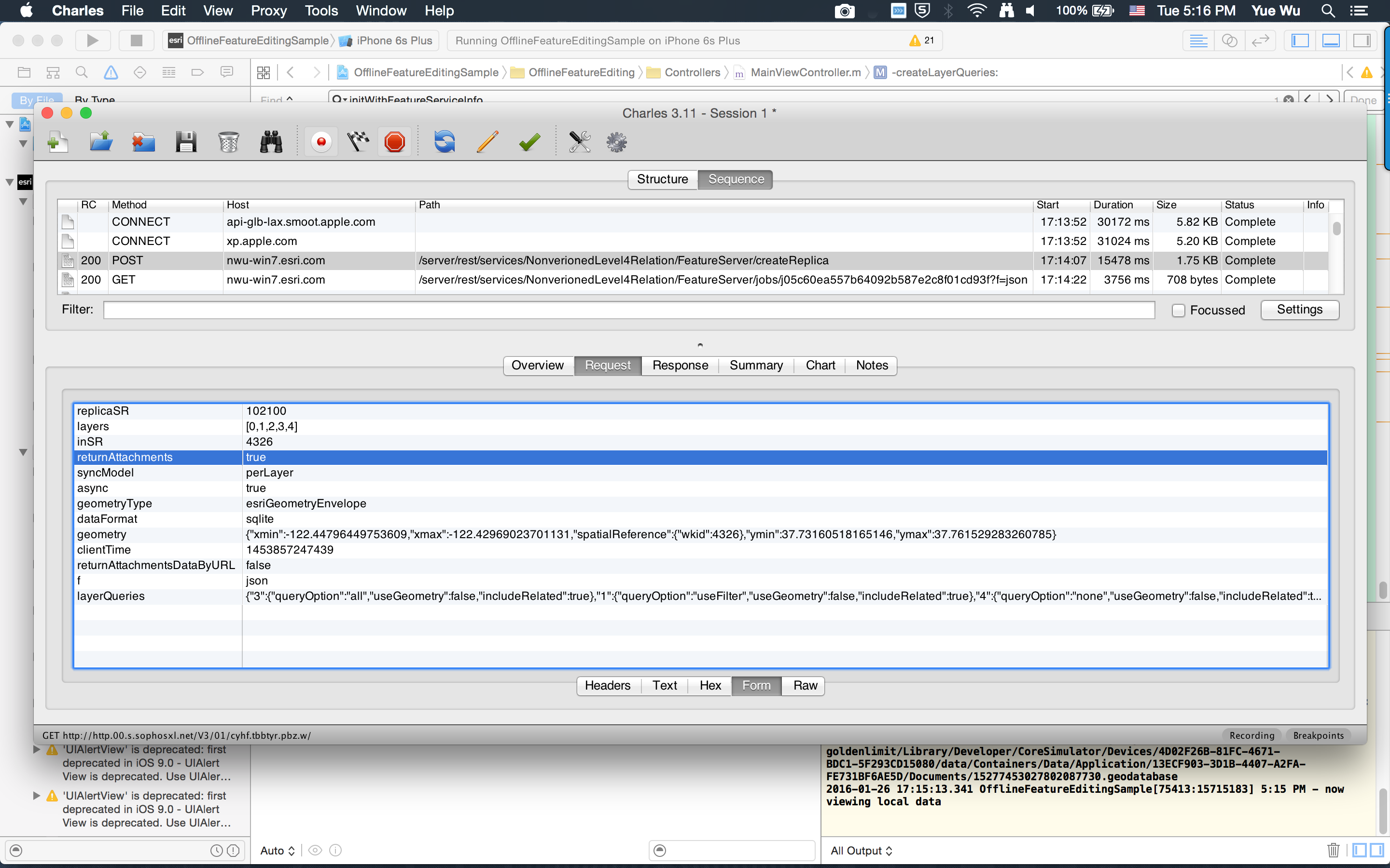

For the issue that not able to create replica, my recommendation is first using this proxy application tool called “Charles” to capture the create replica request that triggered from Xcode simulator to server, and then you can save that request parameters in a file and copy&paste those parameters directly on REST (http://52.28.226.146/arcgis/rest/services/yyy/FeatureServer/createReplica) to see if you can still get 400 error.
Then you can narrow down the issue if it is related to Server or SDK. Most likely, this is still reproduced on REST. Then you probably need to review this online documentation about how to prepare a versioned data for offline map: Offline maps and versioned data—Documentation (10.3 and 10.3.1) | ArcGIS for Server
Hope this can help
