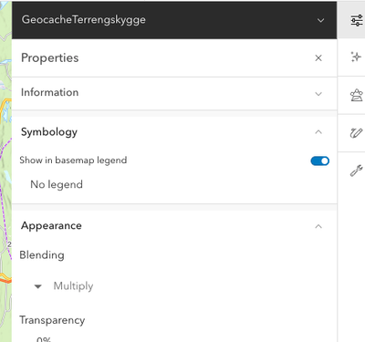

Hi, blend modes for layers is a nice feature for web maps. As far I can see, this is not supported through the native SDKs. Are there any plans to support this feature for iOS or Android?
https://www.esri.com/about/newsroom/arcuser/blendmodes/
https://developers.arcgis.com/javascript/latest/sample-code/intro-blendmode-layer/

I think the main argument to support this is just that one would expect that any webmap item you create in AGOL (where you can setup layer blending) should be supported and look roughly the same on both web and native SDKs.

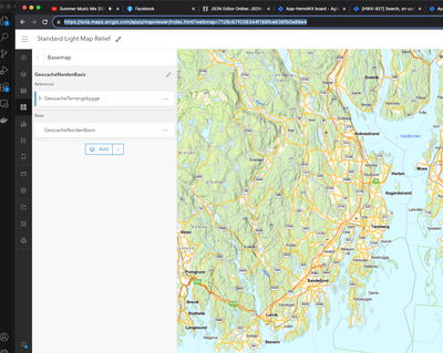

This is important for us. We use it to show World_Hillshade on top of map.
It works on web
But in an app it do not work, attached movie show it

Hi, we have people out working with natural hazards (rockfall, landslide, debris flow, etc) and it is vital for them to see a detailed hillshade combined with topographic map, in order to visualize relevant features on ground.
I was suprised and a bit disapointed when realizing that blend mode is not supported on iOS/Android.
