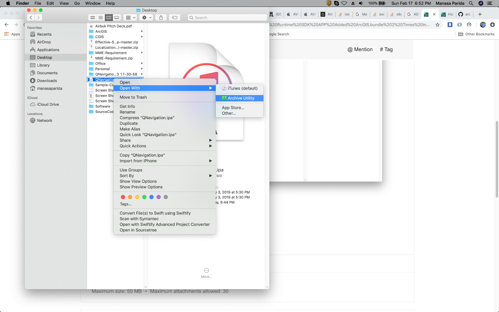

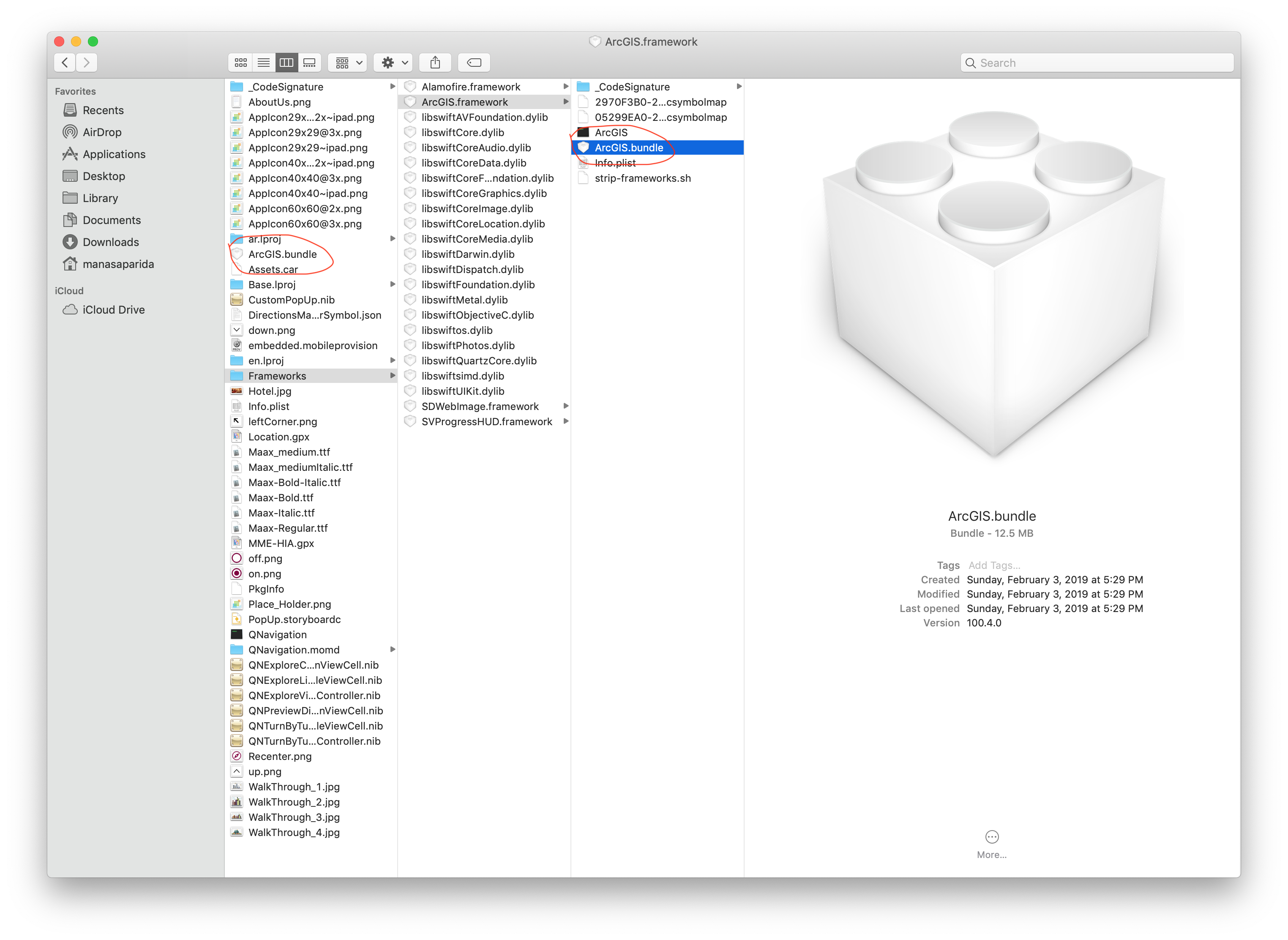

Dear Team,
Could you please find the attached screenshot below when i was trying to expand the Payload package after the iPa

Nicholas-Furness
The first issue is that you've embedded the dynamic framework in your app. This is fine, but if you do that, you should not also include the ArcGIS.bundle in the project hierarchy as it's included in the dynamic framework (as you can see from your first screenshot). Currently, the Guide shows how to add the static framework to your app. We will soon update the documentation to cover the dynamic framework (we used to only provide the static framework), but in the meantime please take a look at this GeoNet post.
See later reply for more details.

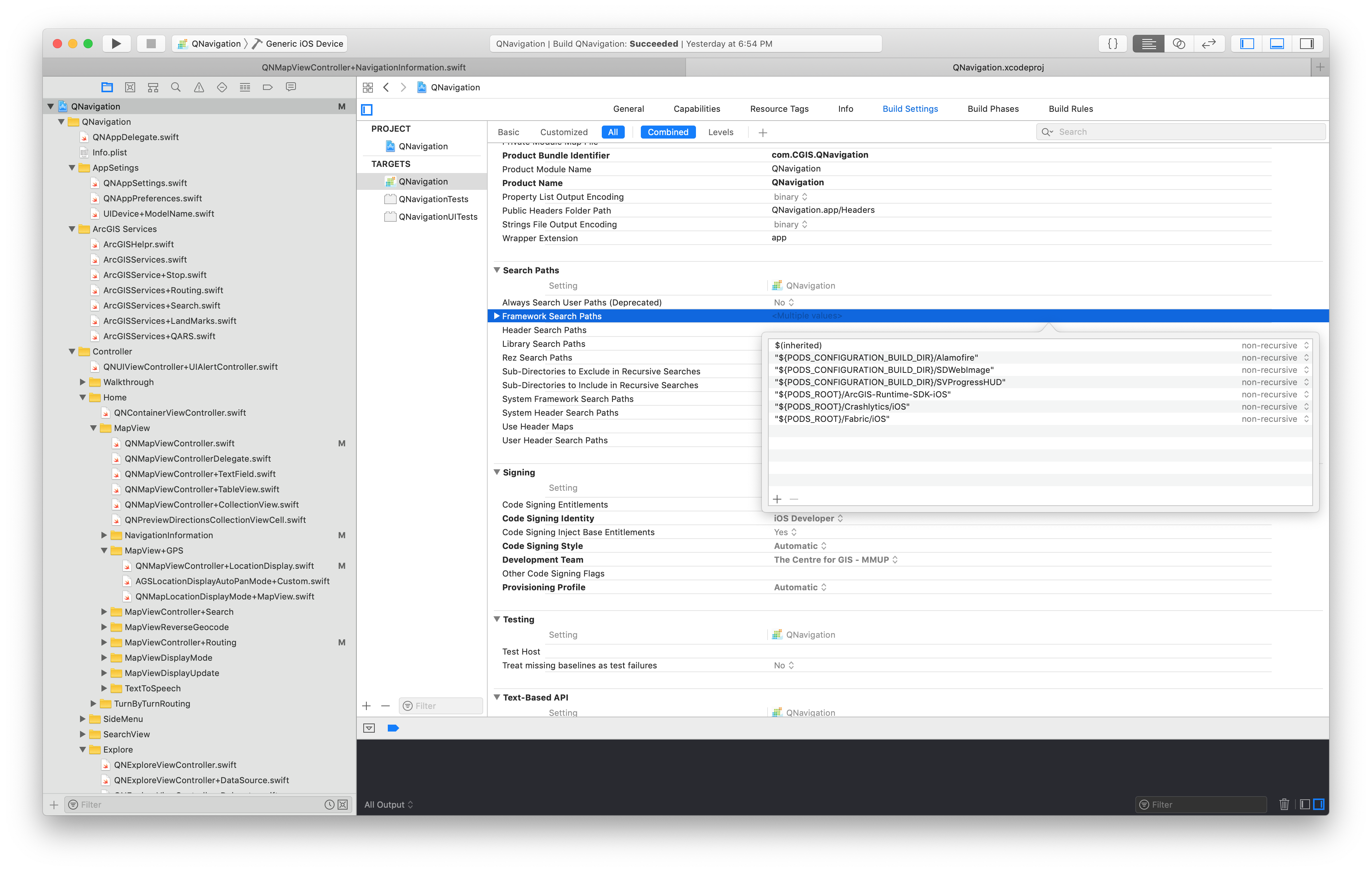

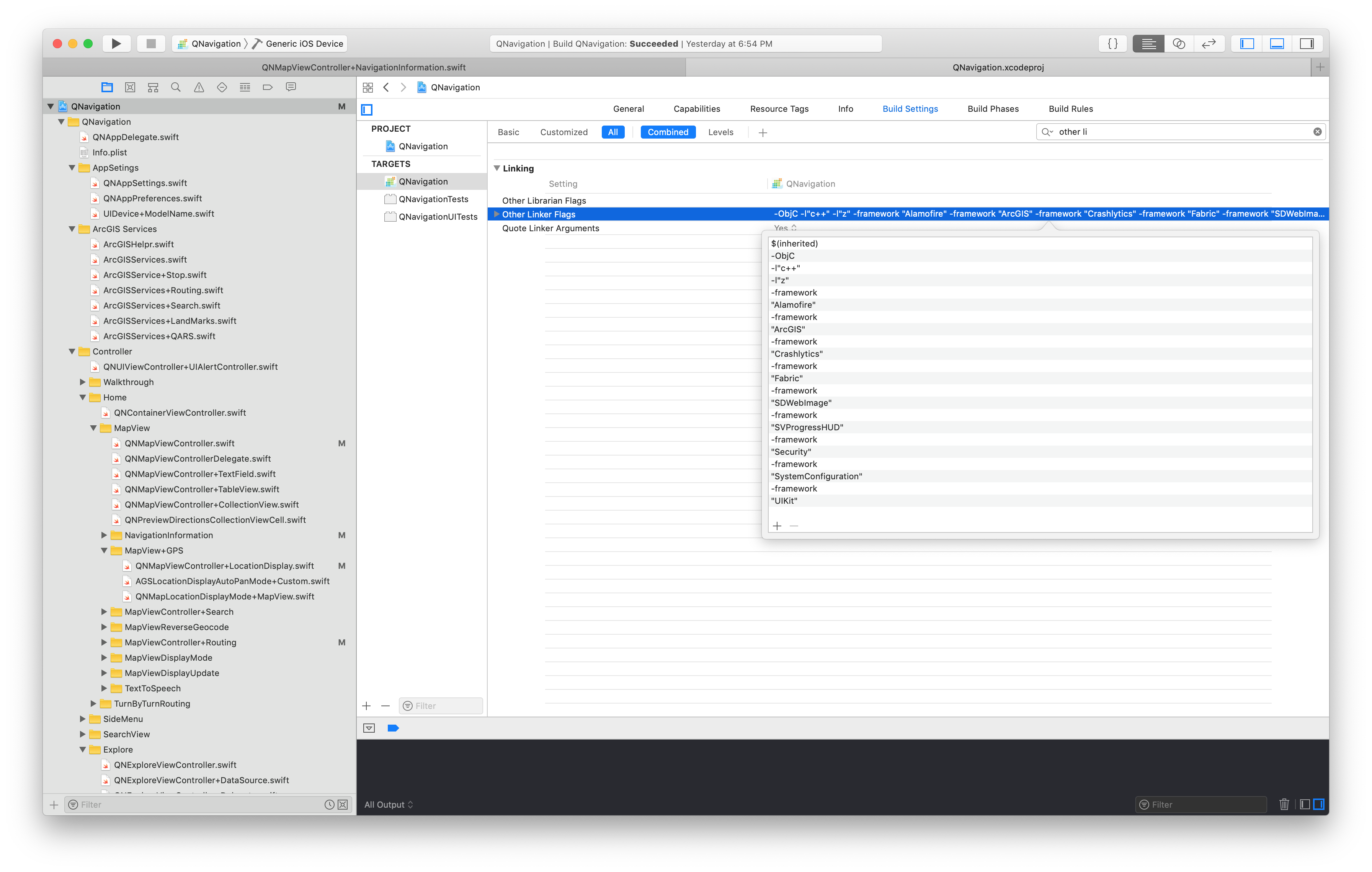

ManasaParida
Dear Nicholas,
Thanks for the update.
Yes, i have embedded the dynamic framework through pod which is really good.
But, i have not added ArcGIS.bundle in the project hierarchy because i remember it was earlier when i was started ArcGIS but from last 4 to 5 Months i am using through pod only, also i have checked my project hierarchy there is no where i had setup ArcGIS.bundle manually rather than pod, please let me know meanwhile i am attaching few of my screen shot for more clarity.
Nicholas-Furness
Just to close this out, after offline discussion (thank you, Manasa) it turns out the dual inclusion was down to a bug in our Cocoaspec for 100.4. This is fixed at release 100.5. Note that the impact on app size is about 1.1Mb (the compressed size of the bundle, which is largely highly-compressible text-based localization files).
