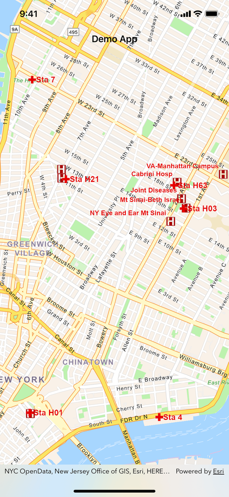

And below is a screenshot for the snippet above.
