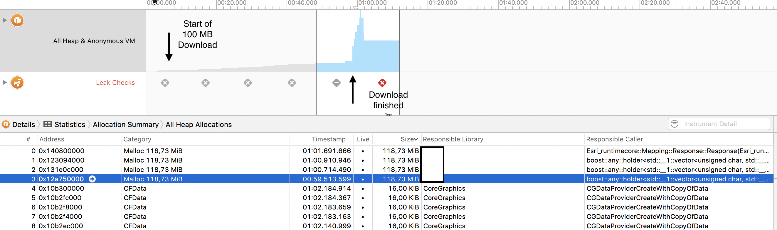

fetchData(completion:)
method on AGSPortalItem can lead to out of memory kills of the app. It appears that shortly before the completion handler is called, the app suddenly needs four times the size of the download in memory with no apparent reason. In my case its an 100 MB Download. This leads to the App getting killed under Memory pressure.
On another note it looks like the complete download is stored in memory the whole time. This is probably not ideal even without the 4x memory bug.

RyanOlson1
This is an issue that I can log and we can look into.
The good news is that in the meantime you can try this workaround below. This kicks off a request manually, telling the request to save the data to disk (instead of memory) and also to use the portal's credentials.
You already have a portal and portal item, so you don't need those 2 lines. The rest should get you going.

LinnartBaeker
I can confirm that this workaround does indeed work as expected. Thanks a lot you are a life saver.
