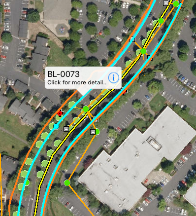

hello,
for two days i trying to fixed issue.
i am using AGSMutablePoint to get Asset present on visible Layers at Click point....
m_mapView.touchDelegate = self;
m_sketchLayer.geometry = [[[AGSMultipoint alloc] initWithSpatialReference:m_mapView.spatialReference] autorelease];
- (void) mapView:(AGSMapView*)m_mapView
didClickAtPoint:(CGPoint)screen
        mapPoint:(AGSPoint*)mappoint
        graphics:(NSDictionary*)graphics {
self.m_queryTask = [AGSQueryTask queryTaskWithURL:[NSURL URLWithString:CurrentLayerURL]];
self.m_queryTask.delegate = self;
AGSQuery *currentQuery = [AGSQuery query];
currentQuery.spatialRelationship = AGSSpatialRelationIntersect;   // i tried all spatialrelation option
currentQuery.outFields = [NSArray arrayWithObjects:@"*", nil];
currentQuery.returnGeometry=YES;
AGSEnvelope *env = [AGSEnvelope envelopeWithXmin:mappoint.x  -10.0 ymin:mappoint.y -10.0 xmax:mappoint.x +10.0 ymax:mappoint.y +10.0 spatialReference:[AGSSpatialReference spatialReferenceWithWKID:dSpatialReference WKT:self.m_mapView.spatialReference.wkt]];
currentQuery.outSpatialReference = self.m_mapView.spatialReference;
currentQuery.geometry=env;
[self.m_queryTask executeWithQuery:currentQuery];
i wanted to get only features where i clicked....and not featured all around... as can be seen from image....
images show two graphics ... it had return me two result at different point but i had click on single point.....
is there any way to reduce search criteria....
if no then when i display result with showCalloutAtPoint for both graphics it display only one last result (BL-0073)as seen from image....how to display all graphics result (for 2nd line)....so that user can click on individual graphics result....

is there any way i can make all result display like one Screen Shot 2016-04-08 at 11.51.07 AM.png
at present showcalloutatpoint display only last result.... at least if query returning 2-3 result as seen from above image .... i need to show all display result not only one BL-0073.....

plz help either to reduce search query result only on click point or show all graphics display result.... so the user know which graphic is belongs to which result....
