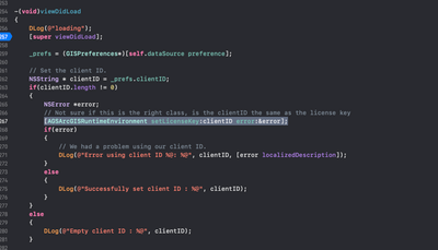

Hi Team,
I have an objective c programming where i'm using
[AGSArcGISRuntimeEnvironment setLicenseKey:clientID error:&error] but it shows the 'Developer License key water mark'.
any idea how to fix it?
Thanks,
Ajitesh

Hi Ajitesh,
Are you setting the correct license key? What your `clientID` string looks like? The format of the license key should look like,
<license level lite/basic>,<number of deployments>,<string>,<expiration date>,<some string>

AjiteshUpadhyaya
Thank you, after changing the format, the watermark issue got resolved.
