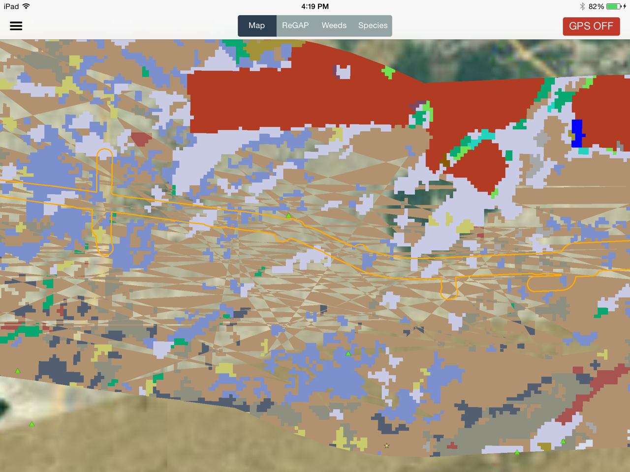

I've got an issue with a large polygon feature layer (~20,000 features).  In the screenshot below you can see a landcover layer.  It appears that the polygon features with multipart geometry are not drawing correctly.  The area in the image with the crisscross lines should all be a single feature surrounding smaller features of different types.  I've tried various repair geometry and simplify tools with no effect.  If I look at the geometry in ArcMap (view sketch) it seems like everything is in the correct order.  It's almost as if the breaks between the multiple parts of the geometry aren't being passed into the runtime geodatabase.
Has anyone had any experience with complex geometries in the runtime geodatabase?

I was able to work around this issue by creating a grid over the extent of the layer in ArcMap and using the Split Polygons tool to chop everything up.  This didn't solve the problem - multipart geometry still doesn't draw correctly, but it did reduce the number and size of multipart features so they are less noticable.  You could also use the dice tool to do this.
It appears that this is a bug in either the offline geodatabase or the SDK drawing routines.

I can confirm that this is indeed an issue. We'll try to fix it in the next release.
As a workaround, you can try generalizing the geometries before exporting it to the runtime geodatabase.
