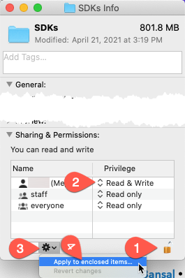

I've had some issues recently where permissions appear to get messed up (I haven't identified the culprit yet, but it may be my anti-virus scanner or MDM software).
Can you try going to ~/Library/SDKs in Finder and make sure that your user has permissions to write? If not, set them (for simplicity I just set everyone to read/write) and then use the cog menu to apply to enclosed items.
I don't know if that's the issue (especially if you've removed the previous version), but seems worth a try.
Can you let us know if that helps?

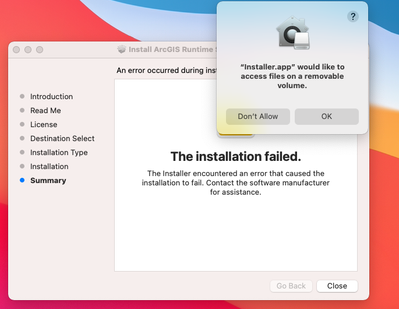

This did not work. I set staff and everyone to read write. I get install failed prior to getting the dialog to access my external SSD. This is where all users/ folder is. I was low on hd space. I Did not have a problem installing 100.10. I tried to reinstall 100.10 and I have the same issue.
drwxrwxrwx    3 webdev  staff     96 Apr 23 11:21 SDKs

That's odd that it bombs now but not when you installed 100.10 before. Have you updated macOS since then perhaps? I assume you have tried clicking "OK" on the permissions dialog, then re-running the installer?
