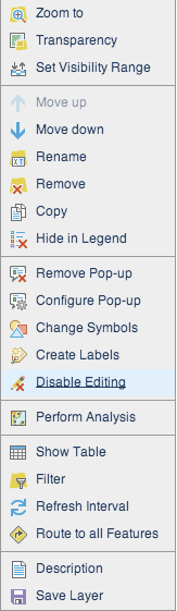

I have an iOS app that loads a webMap and makes edits/updates to the feature layers of that webMap.
In ArcGIS Online, when I view the webMap in the viewer, and click on a content layer I get the following window.
If I Disable Editing on this layer, in my app I can no longer edit the layer.
My question is what does this setting do exactly?  It shouldnt change the edit settings of the layer itself right?

DiveshGoyal
This setting stores some information in the webmap saying that the author has disabled editing on the layer. The iOS SDK, when opening the webmap, honors this setting and creates a feature layer which reports that it doesn't support editing (the canCreate, canUpdate, and canDelete properties on AGSFeatureLayer returns NO). Of course, the backend feature service still supports editing (it remains unmodified), but since the feature layer chooses to not expose this onwards, things like popups (which inspect the feature layer's properties) don't provide the option to edit features in that layer.
If you were to not use the feature layer instance returned by the web map in  webMap:didLoadLayer: delegate method, and instead create your own feature layer pointing to the URL of the feature service directly, your layer would report that it IS capable of editing.

MichaelDavis3
I think that setting controls the ability to edit through the AGOL web map.  An iOS app would be using the feature services directly, and can make changes to any service that allows edits.
