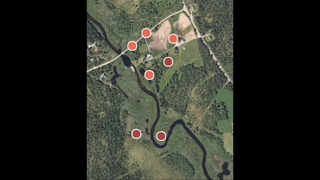

AGSArcGISVectorTiledLayer seem to hide potentially colliding features on the client side. I´ve verified that the data are present on the client when zooming out (see gif).
These data are important observations and the user must see all features, always. Any ideas how to make sure all features are rendered?

If somebody stumbles upon this, the solution is painfully simple, just add "icon-allow-overlap": true in the styling. Default is NOT to allow icon overlap :face-palm:

There isn't any feature reduction built into Vector Tiles, so this seems like it must be a function of how the tiles are baked. Are you creating the vector tiles in ArcGIS Pro? Is there a rendering rule in Pro that would remove this feature as you zoom out?
Nicholas-Furness
One other question: Can you open this vector tile layer in ArcGIS Pro or ArcGIS Online and see if it behaves the same way please?
