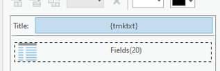

In ArcGIS Pro:
Spoiler
1. Right-click the Layer, select "Configure Popups"AlfredBaldenweck_1-1634143669641.png
3.  Click on "Fields, or customize as desiredAlfredBaldenweck_3-1634143757659.png

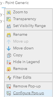

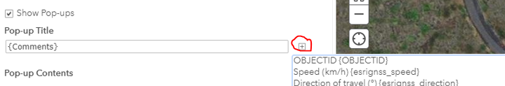

In Map Viewer Classic (ArcGIS Online)
Spoiler
1. Click on the "...", select "Configure Pop-ups"AlfredBaldenweck_5-1634143849581.png

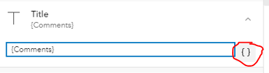

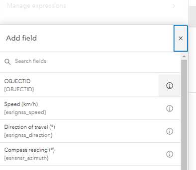

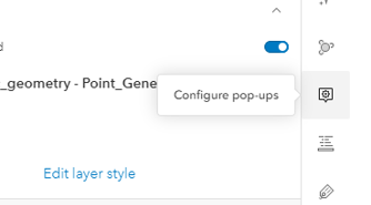

In Map Viewer (Formerly Beta)
Spoiler
1. Go to Layer Properties, and click "Configure Pop-ups"AlfredBaldenweck_7-1634143977405.png
