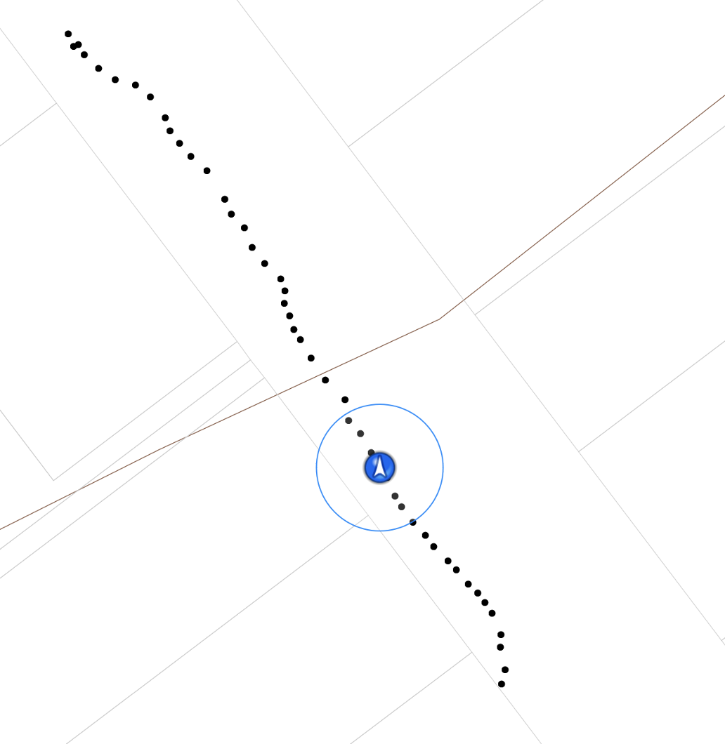

I'm using the AGSNMEALocationDataSource to get the location feed from external GPS unit:
mapView.locationDisplay.dataSource = AGSNMEALocationDataSource(eaAccessory: connectedAccessory!, protocol: protocalString)
When the data source was started, the gps symbol appeared on map. When I started walking, the gps symbol moved with me.  So far so good, it had worked as expected. Then I stopped the data source to turn off the gps symbol and continued walking without the gps symbol on map. I stopped walking at the top end of the black dots as shown in below picture. Now the problem: I started the data source again and the gps symbol appeared on map again, but the gps symbol was not at my current location - the top end of the black dots. It did not catch up with my current location! It was stuck where the data source was stopped. Then when I moved, the gps symbol did not move at all and stuck there forever...
However, with the AGSCLLocationDataSource I did not have the above problem.
Any idea?

ShiminCai
Hi there,
Never mind! Figured it out based on the ESRI sample code "Display device location with NMEA data sources". Just need to recreate the AGSNMEALocationDataSource object and assign it to the mapView.locationDisplay.dataSource before call mapView.locationDisplay.dataSource.start(). I think the connectedAccessory need to be refreshed when the dataSource is turned back on after it is turned off. You don't have to do this with the default location datasource though.
