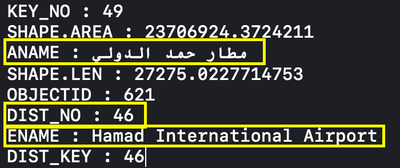

DavidFeinzimer
Hi Afroz, the fields ENAME, ANAME & DIST_NO should be accessible from the district feature layer.
I've attached a simplified version of the code. Tapping a green outlined district will produce a console message with the information. For example, tapping the airport:
I hope this helps!
David
