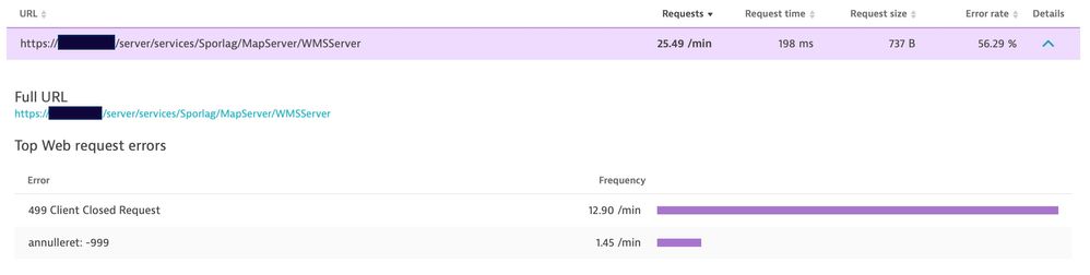

It is certainly that error code, but I'm not sure it matches my situtation.
The app works and I don't hear complaints from the users about the map service - I only see this very high error rate (> 50%!) in the monitoring tool and wonder where they come from.
I'm not that familiar with WMS-services, so the article doesn't make total sense for me, but as I understand it, if it was an authentication issue, it would fail 100% of the time.
The authentication against the service is a plain username and password.
Here's a screenshot from the monitoring tool:

MarkDostal
@Selsoe The following is from a colleague who works with WMS Services:
499 errors are expected to happen over connections that suffer from a load interruption. These are just an internal server code that means that the client has closed the connection before processing the request and receiving the reply. I don’t think there is an authentication issue here. The errors might look worrying but I wouldn’t be alarmed especially that the user application is not affected.
So nothing to worry about.
Cheers,
