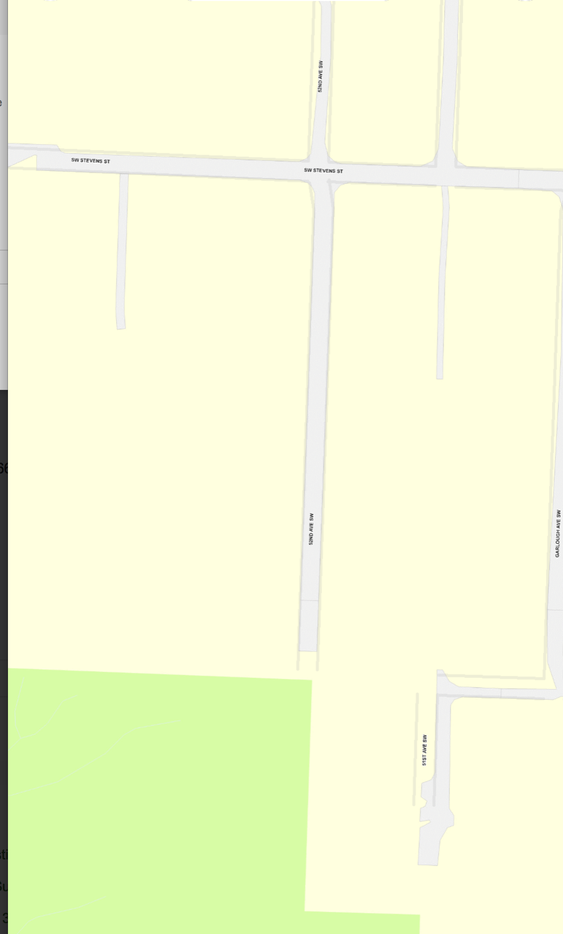

The problem happens at high zoom levels.
Try this polygon
AGSPolygon: [[(1254577.712545, 214993.623308), (1254577.712545, 213410.613883), (1253846.642921, 213410.613883), (1253846.642921, 214993.623308)], sr: 2926], sr: 2926

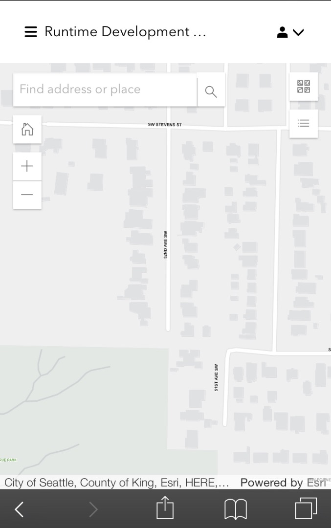

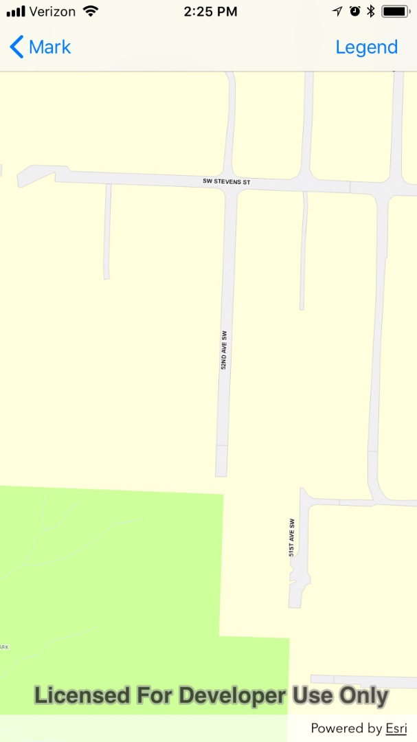

I can see that at that zoom level the labels are pretty small.  For comparison, I ran a test app with your data on an iPhone 8 and also loaded a map with the same labels in Safari on the same iPhone 8.  The results are almost identical, so I don't think there's an issue with DPI on Retina displays.  With the 100.x releases we are basically interpreting DIPs the same way that the browser does. That’s the justification for the change from the 100.2.5 behavior.
Safari - ArcGIS.com map viewer
Test app using Runtime SDK for iOS - iPhone 8
