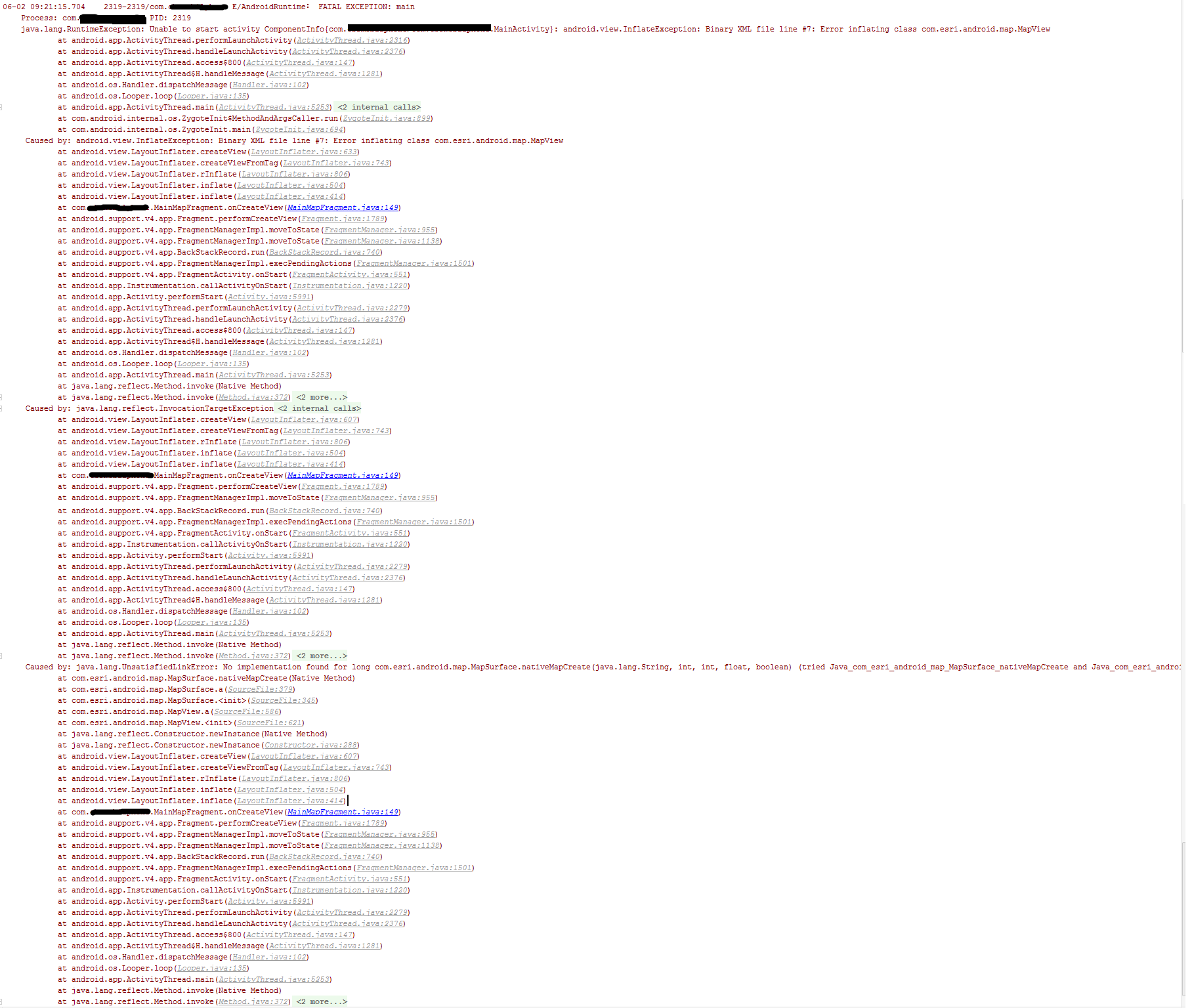

Hello everyone I've been developing an app so far. Last weekend my test phone (Asus Zenfone 5) took Android Lolipop update, when I try to test my app at the my phone It gives me error; Error inflating mapview xml. But when I test app on the Kitkat version (4.4.2) It works without any error. How can I solve this issue ? Is this caused by my codes or Is this caused by Esri Android API?
Thanks everyone for patient.
Here is my LogCat;
And here my gradle file;

DanO_Neill
Deactivated User
The fix is in the latest version of ArcGIS Android SDK 10.2.1-1  Update your gradle files to use 10.2.6-1.
dependencies {
   compile 'com.esri.arcgis.android:arcgis-android:10.2.6-1'
DanO_Neill
Deactivated User
The issue is with the libs provided in the AAR dependency module not working as expected on x86 lollipop devices.  At issue is an arm library is being deployed to an x86 device which Intel runs on x86 devices via Intel Houdini binary translator​ which allowed your test app to be run on your x86 phone. The Houdini translator does not currently work on Lollipop devices so the app stopped running and requires x86 libs.  We are working on updating our AAR lib module to address the issue and get your apps back working again.
DanO_Neill
Deactivated User
The fix is provided in the next update release for 10.2.6 and has been tested to resolve Salih Yalcin​ issue.
