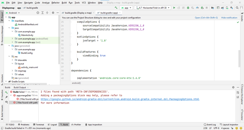

When running the app, I get the following error message.
"2 files found with path 'META-INF/DEPENDENCIES'.
Adding a packagingOptions block may help, please refer to https://google.github.io/android-gradle-dsl/current/com.android.build.gradle.internal.dsl.PackagingO...
for more information"

I'm having the same issue with 100.12. It was working fine on 100.10. @DiegoMendes_Rodrigues were you able to resolve the issue?
RamaChintapalli
Hi,
Thanks for pointing this out. Yes, the internal changes at 100.12 require packing options to exclude `META-INF/DEPENDENCIES`. We will update the tutorial.
You can include the packaging options in you build.gradle file as below,
packagingOptions {
   exclude 'META-INF/DEPENDENCIES'
Thanks
