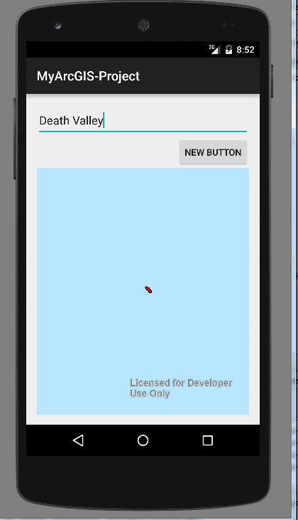

I'm making a simple app to Query Features (Polygons) and then zoom to results , but when it zooms the zoom is too far (no envelope padding in the setExtent method ) , I barely see the feature , and it doesn't zoom more than this even with the manual double tap technique

Have you tried this?
  1. Collect all of the extents of the selected features into a Geometry[] array
  2. Use GeometryEngine to union all the extends into one Geometry
  3. Use the extent of the resulting Polygon as the new extent for your MapView.
That might be one way to do it.
You might also be able to call merge(), merging each Envelope with the next until you've merged them all.
I hope this helps!
