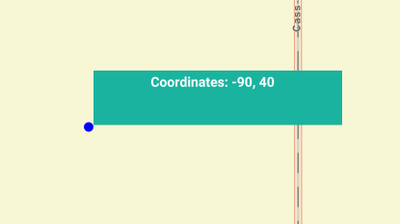

Hi All,
   The SDK version is 100.15.0
   Here is my java code for create a text symbol with background color. And the requirement is setting a round corner for the style. Is there any way to implement it by the SDK now?
TextSymbol textSymbol = new TextSymbol();
textSymbol.setHorizontalAlignment(TextSymbol.HorizontalAlignment.LEFT);
textSymbol.setFontWeight(TextSymbol.FontWeight.BOLD);
textSymbol.setSize(14);
textSymbol.setColor(0xFFFFFFFF);
textSymbol.setBackgroundColor(backgroundColor);
textSymbol.setText(information);
textSymbol.setOffsetX(offsetX);
textSymbol.setOffsetY(offsetY);
This is the style now.

LeoDeng
Hi Priyanka,
    Sorry for the confusion. As you see in the image, there is a rectangle background for the text symbol. My target is to create a text symbol with round corner background. I didn't find any clues in the API document or demos either.
Thanks,
Leo
PriyankaRupani
Currently, we don't support adding rounded corners to text symbol background. Is it important for your workflow to have rounded corners to the text symbol background?
You could alternatively use a `Callout` which does have rounded corners.
LeoDeng
Yes. The target style is similar to the defalut callout demo. Howerver, in the callout style I met another trouble.
The callout‘s behavior is worse than the text symbol when user pan the map. Is there any symbolization solution for the callout style?
I appreciate your comments.
