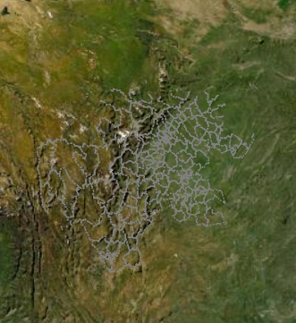

MarkBaird
I've tried adding your feature later to a map using our latest release (100.9.0) and it displayed without any issues.
I was basically swapping your service into this app on github:
https://github.com/Esri/arcgis-runtime-samples-android/tree/master/kotlin/feature-layer-feature-serv...
I had to zoom to a different area, but I could see your data:
Does using this code help?

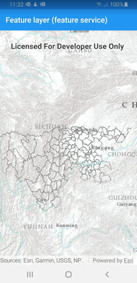

MarkBaird
The screenshot in my previous post was grabbed from running it in a desktop Java Runtime app which was for convenience.
I does however work on in my Kotlin Android app too.  This is the modified onCreate method from my app:
  override fun onCreate(savedInstanceState: Bundle?) {
    super.onCreate(savedInstanceState)
    setContentView(R.layout.activity_main)
    // create the service feature table
    val serviceFeatureTable = ServiceFeatureTable("https://hbsyb.booway.com.cn/arcgis/rest/services/zjsxyd/sichuanxianjixingzhengqu/MapServer/0");
    // create the feature layer using the service feature table
    val featureLayer = FeatureLayer(serviceFeatureTable)
    // create a map with the terrain with labels basemap
    ArcGISMap(Basemap.createTerrainWithLabels()).let { map ->
      // set an initial viewpoint
      //map.initialViewpoint = Viewpoint(
      //  Point(
      //    -13176752.0,
      //    4090404.0,
      //    SpatialReferences.getWebMercator()
      //  ), 500000.0
      // add the feature layer to the map
      map.operationalLayers.add(featureLayer)
      featureLayer.loadAsync()
      featureLayer.addDoneLoadingListener {
        val extent: Envelope = featureLayer.getFullExtent()
        mapView.setViewpointGeometryAsync(extent)
      // set the map to be displayed in the mapview
      mapView.map = map
This zooms to the extent of the layer once it is loaded and on my Samsung phone looks like this:
If you use my code, does this work for you?
