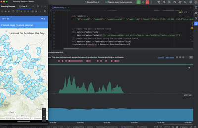

I have tried your service and applied your renderer in one of the 100.15.5 samples and see that memory stayed around 400-600MB as I pan and interact with the map with above provided feature service. I also tried the same in 200.x version samples and the behavior was same.
Is there potentially something else happening in your app that is causing the memory spike? Or am I missing any other repro steps needed?
