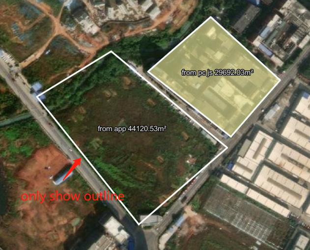

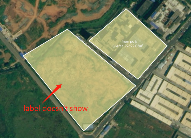

1.In APP, I set the layer display label, but the created polygon doesn't display the label. The polygon create from js client dispaly well.
2.In PC, I use the coordinate which get from App but it doesn't display as a polygon, it only rendered the outline.
the polygon display in PC:
the polygon display in Android:

I solved the problem, the geometry get from sketcheditor is not topologically consistent. so I guess in PC it can't render as a polygon and in Android, it can't find the center point to show label. I use  GeometryEngine.simplify to make it topologically consistent and now it render well in PC and Android.
