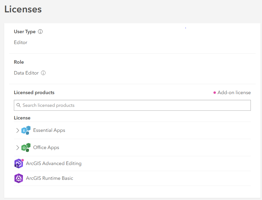

My license
Thanks in advance!

RamaChintapalli
Since the error is coming from applyEdits, it suggests the enterprise service is returning this message. Can you check if your Advanced Editing licenses assigned to the users or may be it requires the licenses to be reassigned as suggested in this blog
Rama
