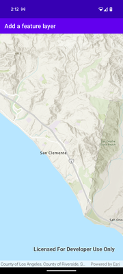

Sorry, I got the device name wrong before. Our device is also a Pixel 9 Pro XL. So it looks like the same device. Surprised that it is crashing for them. Here is a screenshot of simple map rendering app. What does your app does on launch, just load map or anything else? I can try to repro it on our device.
