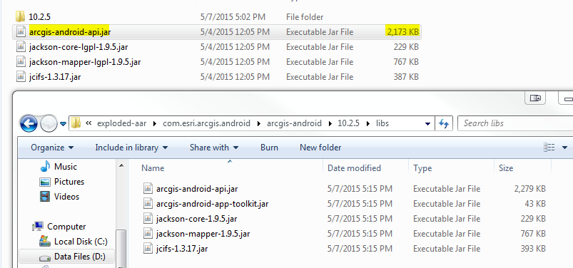

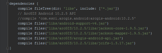

Bryant_JamesLanuza
Hi all,
    Sync is working if I'm using old library "arcgis-android-api.jar",  to change path file dependency.dependencies.PNG
DanO_Neill
Deactivated User
Nabeel Adnan​ This is a known issue with respect to the SDK distribution provided through Bintray maven repository.  This fix is already in the 10.2.5 local libraries as Bryant James Lanuza​ mentioned above.  This will be addressed in the next minor release of the Android SDK, 10.2.6, such that you can continue to work with the artifacts through our bintray maven repo.
