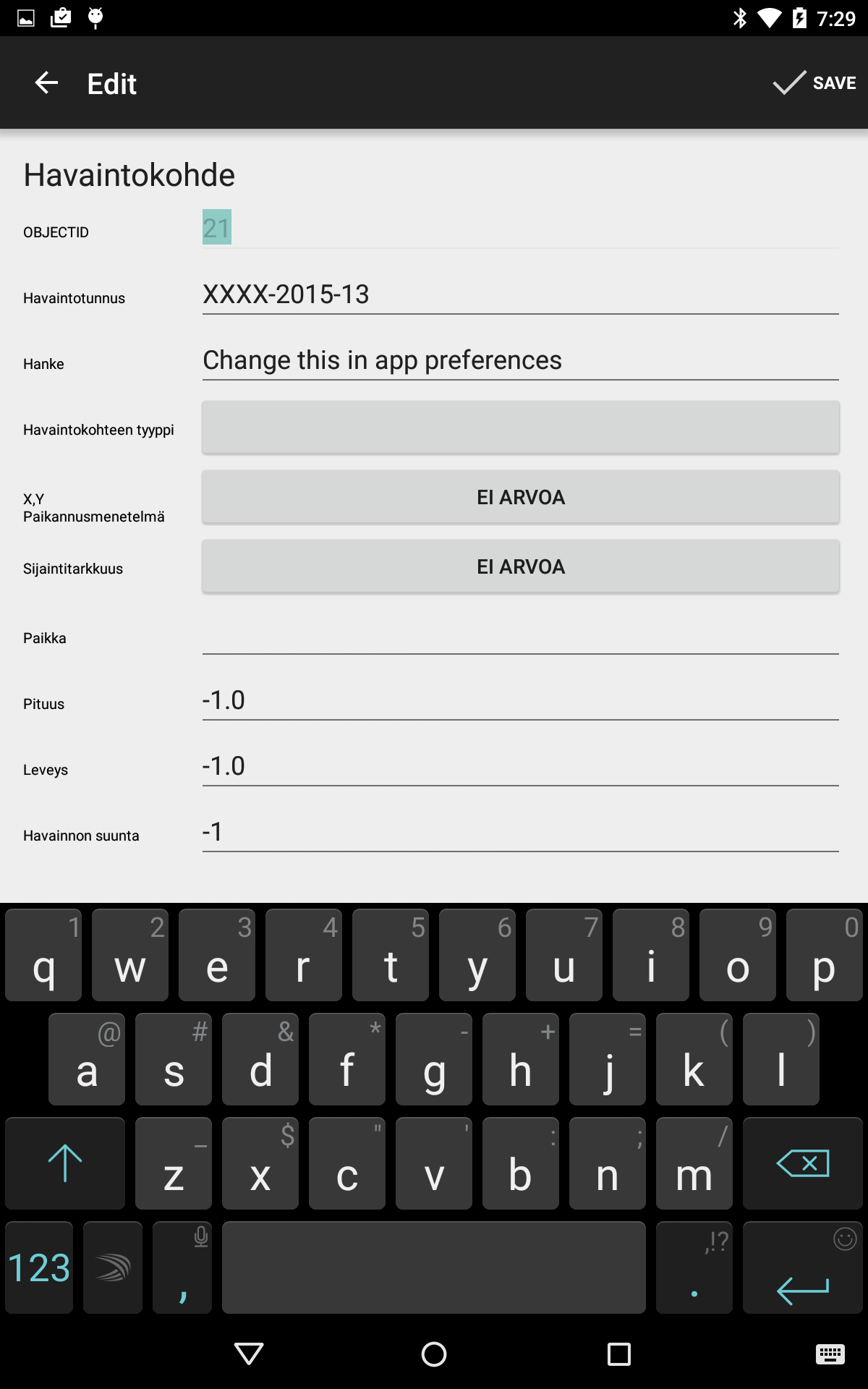

[Unfortunately] I don't think there is any feasible way to make ArcMap created databases and content editable. For me services pattern was too annoying and I went on with adding Spatialite database to my project - They are editable but of course you have to write your own handlers for editing and showing your data on the map. Screenshot_2015-04-27-07-29-49.png
(Reasons: Services way doesn't support complex enough relationships for our organizations needs and you must use new ArcGis server or ArcGis online for serving that data. We want this app to be desktop-pda-desktop, not Desktop-[adminperson]-Server-[gisexpert]-Pda-Server-[adminperson]-Desktop. And we also wanted it to be fully offline-able.
