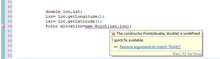

Hello all, I am new to ArcGIS-Android development environment.
I want to draw a point that shows my location, I used the following steps:
Defining a location variableز
2- Get the longitude and latitude from the location.
3- Creating a point from the longitude and latitude.
However, when I define the point that takes the longitude and latitude, I get an error (shown below in the screenshot). What might be the issue here?
Here is my code:
Location loc = null;
                double lon,lat;
                lon= loc.getLongitude();
                lat= loc.getLatitude();
                Point mlocation=new Point(lat,lon);

Try the following code to show the point.. also check what you imported.. the Point class should be com.esri.core.geometry.Point , and I think Android has a Point class as well.

HaniDraidi
Dear Mengyi,
I did exactly what you suggested (using this link) in a new project, but I get an error when creating the graphic point  using :
Graphic pointGraphic = new Graphic(pointGeometry, simpleMarker);
I get this error: "The constructor Graphic(Point, SimpleMarkerSymbol) is undefined"
And it asks me to change the type of point to geometry or remove the arguments!!

It seems that I should use Geometry pointGeometry = new com.esri.core.geometry.Point(-302557, 7570663);instead of Point pointGeometry = new Point(-302557, 7570663);

I see. However, com.esri.core.geometry.Point is the subclass of Geometry. So I think
should work for com.esri.core.geometry.Point
The reason why it gives the error maybe Point you are using is the Point class in Android rather than com.esri.core.geometry.Point. You can also try import com.esri.core.geometry and use Point directly.
