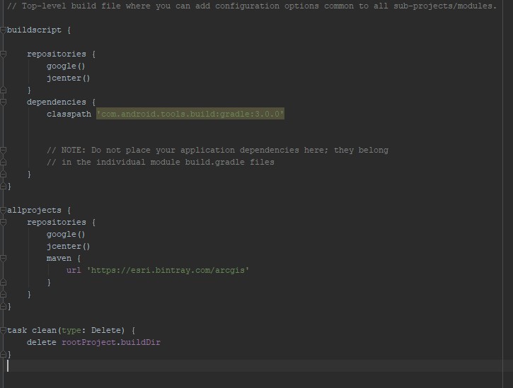

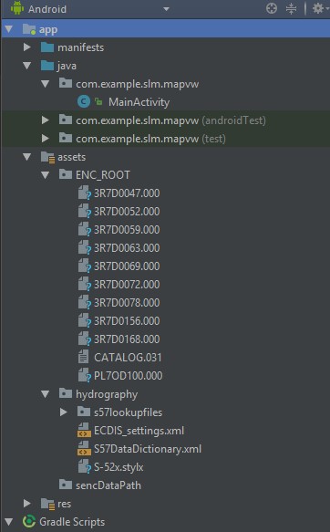

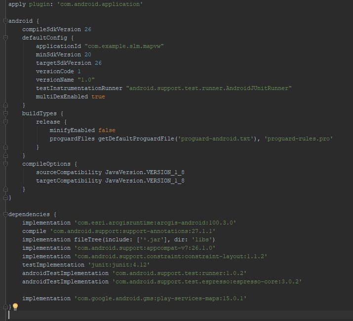

Hello, we are trying to create an app that show our local *.000 sea map file with Android Studio. We wrote some codes like the tutorial  here for displaying ENC. But they aren't working. Could you help us? Where exactly did we wrong or could you send us a code?
So here our codes in MainActivity:

And also our build.gradle's and resource folders:
Thank you in advance!

RamaChintapalli
Hi,
Can you try copying the data to the external storage directory.
You can get access your external storage in the app using
Environment.getExternalStorageDirectory()
Environment  |  Android Developers
Thanks
Rama
