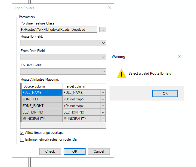

Hello Roads and Highways users,
I created the ALRS and I am trying to load the routes. I am prompted to select a single route Id from the drop down. Please see first screen below.
Select route id field
My LRS network is configured to use the three fields in the screen below. Please advise on how to get over this.Three fields are expected to uniquely identify my route in the network.

NathanEasley
Hi Ihab,
If you're getting that error message, it means the value in the Route Id field doesn't match the concatenation of the three fields that compose the Route Id.
You might want to take a look at these two topics related to Concatenated Route Ids and Padding and Null settings for a multi-field Route Id for more detailed information about how to compose your Route Id field values.

NicoleHanson1
Hi Ihab!
You'll want to use the field that has the concatenated fields (there should be one field that has the combination of the other three fields that make up your route id).

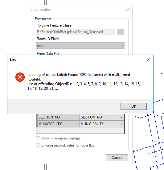

Thanks for your response .I added a field and calculated its values to concatenate the values from the three fields. When I attempt to load the routes, I get the malformed RouteId error below. Does the roads and highways product expect a special field separator in routeId between the three fields ? Thanks again!

ElAttar__Ihab
Thank you Nathan for putting me on the right track. I unchecked the "fixed length" since the values of those fields in my record vary from null to the length of the field and checked "Allow null values" for municipality and section_no fields and this fixed the problem.
