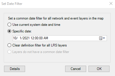

Thus far, I've used the Set Date Filter option in ArcMap to set a specific date of 10/1/2021 (see attached). SetDateFilter.pngSetDateFilter.png
Next step involved exporting this Roadway Network layer in ArcMap to a file GDB. Additionally, the similarly filtered calibration point and route intersection layers were exported as well. After this, I cleared the records in the Roadway network layer and then loaded the records from the Roadway network layer in the file GDB (dated 10/1/2021). I'm not sure if this workflow will work for this purpose, but I'm open to everyone's feedback.
