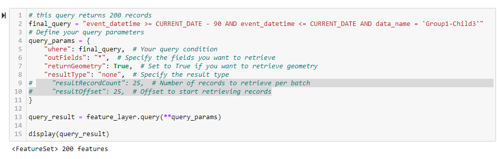

Hi,
I am querying the REST API of a hosted feature layer using a Notebook within ArcPro 3.1.0. The query without any pagination returns 200 records.

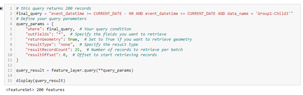

If I add resultOffset of 0 and resultRecordCount of 25.  The resultRecordCount seems to be ignored and all 200 records are returned.

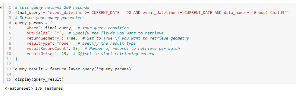

If I set the resultOffset to 25 I get 175 results.  Again ignoring the resultRecordCount but returning results from the offset position.

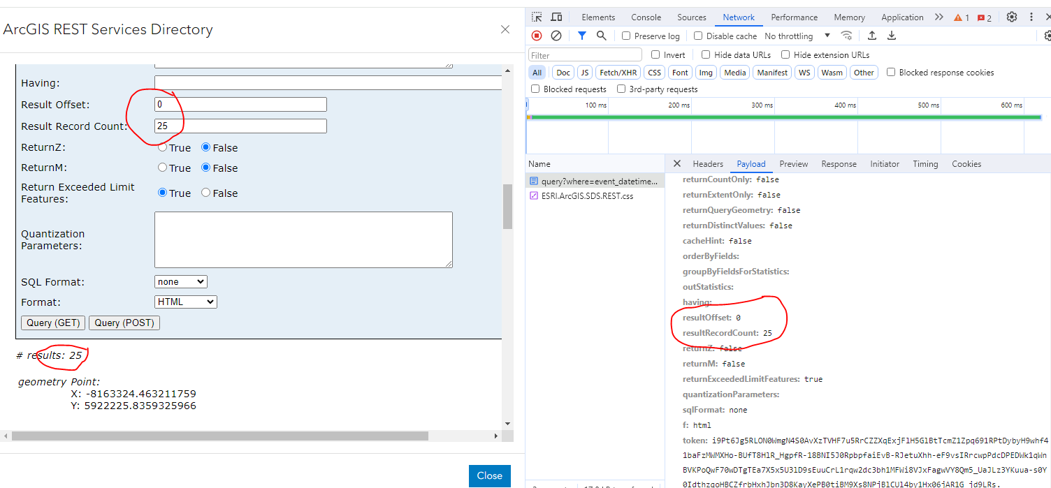

If I use the REST API web page instead and query using resultOffset of 0 and resultRecordCount of 25 it works and returns 25 records as expected.
