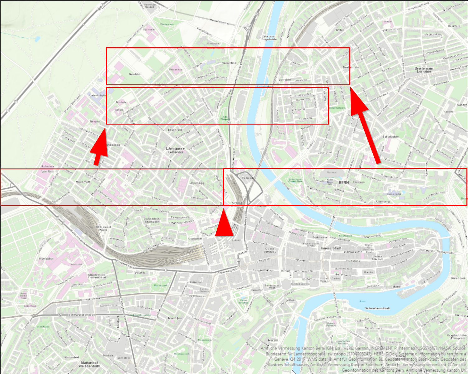

The issue with both approaches is, that the center of the returned image is not in the middle of the given longitude and latitude (East/North) coordinates. The given point is always on the left side. See the issue illustrated in the following picture:Left_side_illustration.png
How ist the calculation from a point to an area done right? What did I forget?

The solution is that the base map uses wgs84-web-mercator-auxiliary-sphere. With the converted coordinates into https://spatialreference.org/ref/epsg/ch1903-lv95/ there is a deviation which leads to this inaccuracy. (https://spatialreference.org/ref/sr-org/epsg3857-wgs84-web-mercator-auxiliary-sphere/)

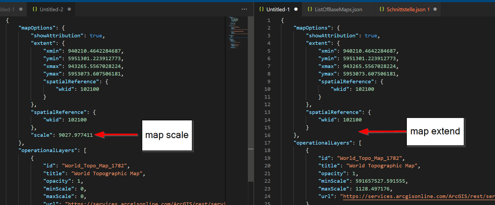

i am not sure why that would be off center. add x degree right and left should not change the center. I have 2 suggestion;

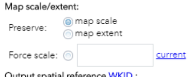

The issue might lie with the print endpint. can you try both preserver map scale and map extent?
Secondly, can you take the point and create a buffer then use the extend of the buffer to get your coord and try?
pmi
Thank you for your response.
As I figured out the preserve option for map scale sends the scale in the JSON and map extend does not send the scale. Unfortunately, this did not bring the desired centering. The centering is a little better without the scale, but therefor whit out the scale the zoom too far away:
