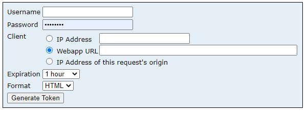

I am working on an ESRI Hosted site.
I am trying to automate the ESRI token web page Generate Token form ie:
I used a Python POST:
user_name  = 'me'
pass_word = 'my password'
referer = 'https://company.cloud.esriuk.com'
referer_name = 'https://company.cloud.esriuk.com/portal/sharing/rest/generateToken'
token = ''
expires = 90
##data = {username=user_name,password=pass_word, client=referer, referer=url, expiration=90, f=json}
requests.post(user=user_name, password=pass_word, client=referer, referer=referer_name, expiration=90, f=json)
print("Generating token")
I also tried:
gis_server = GIS(url=f"server_base_url/web_adaptor/admin",
token_url=f"server_base_url/web_adaptor/tokens/generateToken",
username="admin_user",
password="admin_password")
print(token)
I just get the process finished, no output??
Any suggestions?
Regards,
Clive

Since client/client_id/referer are not the same thing, can you share your code again?
CliveSwan
Hi Joshua,
The client is a Webapp URL: https://company.cloud.esriuk.com/
The code is:
