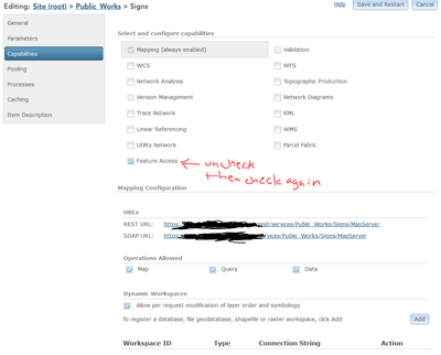

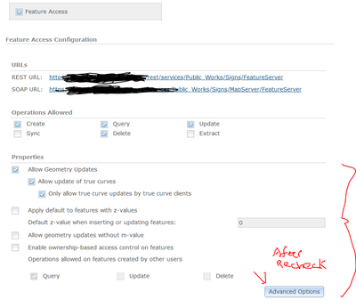

AaronVaughn1
Updating this thread as I am working on 10.9.1. When I go to capabilities and look at the feature access this filter web content is not to be seen, no radio button, checklist whatever. Then, fooling around, I unchecked feature service, then checked it again and more options came up, including the 'Advanced Options'. And therein was that silly hidden check box where I could uncheck filtering. This is so one layer, and one column's notes field, didn't have the json parser flagging the field worker's clever arrow emoji ----> as 'untrusted' html (I spend way too much time on troubleshooting this). Here's the snip:
