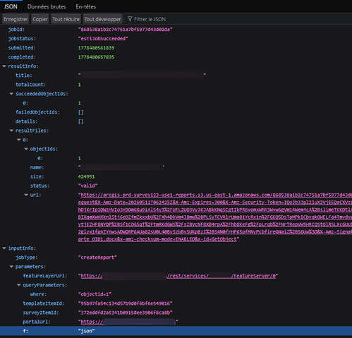

Then you can run your request in debug mode (I did it in PyCharm) and get the response, it will contain something like :
'{"jobId":"868538a1b2c74751a7bf5977d43d02da","jobStatus":"esriJobSubmitted","submitted":1778480561839,"resultInfo":{"title":""},"inputInfo":{"jobType":"createReport","parameters":{"featureLayerUrl":"https://your_portal_url/ags/rest/services/your_service/FeatureServer/0","queryParameters":{"where":"objectid=1"},"templateItemId":"95b97fa54c134d57b9d0f6bf6e549016","surveyItemId":"372eddfd2a5341b0915dee3906f8ca8b","portalUrl":"https://portalurl","f":"json"}},"success":true}'
From this, you can check the job querying the URL
https://survey123.arcgis.com/api/featureReport/jobs/868538a1b2c74751a7bf5977d43d02da?portalUrl=https...
Once generated, the response to this will contain the URL link to download the report :
