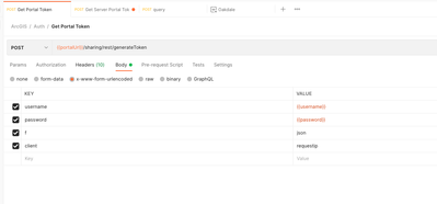

step 1 - get a portal token:

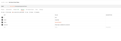

Step 2 - pass portal token to get a serverToken:

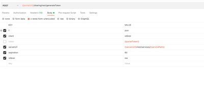

Step 3: pass server token to the query endpoint

Update - I found the issue. Using client:requestip didn't work. No reason as to why - but after changing the client to referer and setting `referer=some-referer` I was able to use the token.
