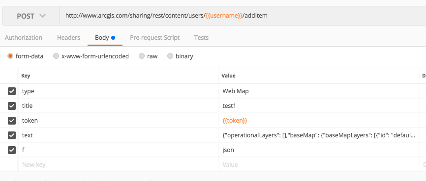

Following the instructions on this page Working with users, groups, and items—ArcGIS REST API: Users, groups, and content | ArcGIS for Devel... I was able build a POST request in POSTMAN  to add a new item to the user.
After getting the token, when I try the POST request to add the web map I get this error
{"error":{"code":403,"messageCode":"GWM_0003","message":"You do not have permissions to access this resource or perform this operation.","details":[]}}

Turns out I was using the wrong access token. I was using the app access token instead of the user access token.
With the user access token it works now.

Yik-ChingTsui
I had this problem too. Turns out you need an OAuth token and not the token from generateToken. The code I used is here: https://gist.github.com/YikChingTsui/ff6d7b6126db73a77e5845576250177d
