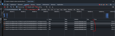

I've been expecting to see some clear 'it's from cache' cue in the chrome dev tools... but never see a 304 response or 'disk/memory cache' in the size column and the response header always displays: the max-age:0;must-revalidate... chalking it up to the 'javascript fetch/etag' implementation and whatever about security that esri mentioned.
So, the chrome dev tools network tab has a handy little checkbox "Disable cache'.  Using this and the same service from two different servers (one with the cache control set and one without), I see this:
Requests to first server with cache control setting at 3600 
Enabled, Enabled, Disabled, Disabled, Enabled
I had been hitting the service a bunch so the first requests are already cached (small), then disable the local cache, boom... larger network transfer, then re-enable the local cache, back to smaller
Requests to second server with cache control setting not defined
Enabled, Enabled, Disabled, Disabled, Enabled,
Always 709, as expected no difference b/c there's no cache setting
Painful but I think isn't enough to convince myself it's doing what I want and it's worth deploying the setting.
