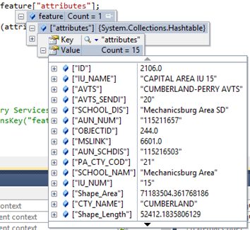

Here is a sample of my returned data when I ask for all columns to be returned. Neither the “ID”, “OBJECTID” or “IU_NUM” are helpful.
They all relate to the returned school district, and not the lat/long I sent to the server.
I also tried returning the geometry with the results. I’m not sure what “rings” are but none of the values are associated to the lat/long I sent to the server.
I just need a way to associate the results with the records I sent to the Rest API query. Am I going about this wrong or perhaps missing something? I would so appreciate some help.
