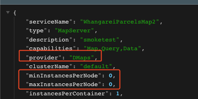

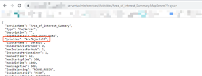

TrevorH_OPE
That’s what the provider setting indicates.
If it’s DMaps it’s shared pool. If it’s ArcObjects it’s dedicated.
TrevorH_OPE
So this is a dedicated service
This is a shared pool service - notice the instances are set to zero
MatthewGeorge
What version of AGS is that from? I'm seeing min/max of 1/2 for shared and no provider property.
