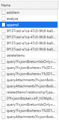

I'm writing a Python program to publish (append) data to an ArcGIS Online feature layer, every 10 minutes.
I am having issues understanding how to implement the ArcGIS REST API method required to achieve this.
  1. Doing testing with the 'Update Data > Append Data to Layer' button in ArcGIS Online;
  2. I uploaded a test .csv file and inspected the network activity in Chrome developer tools;
3. I was hoping to mimic these requests, but instead of a .csv file, the data comes from a json string in code.
4. Are addItem, analyse and append all required for this operation?
5. My understanding is that addItem requires a 'file' to be uploaded. Can I get around this by sending the data in the append request? Perhaps as a featureCollection?
This all seems quite complicated, as compared to the updateFeatures method which I have used previously.
