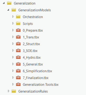

When you install Production Mapping Product Data, you will find a Generalization folder within the install location. The Generalization Models subfolder contains all provided models in a series of numbered toolboxes. The Generalization Tools.tbx toolbox provides tools used within the models as well as a tool called Run Generalization which executes the generalization models in order and as defined by settings in the rules spreadsheet provided by the user. The Generalization Rules folder contains pre-configured generalization rules spreadsheets.
