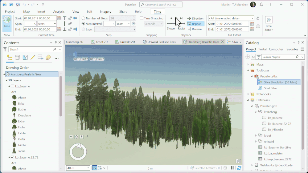

we are doing fancy tree growth simulations an visuslise them in ArcGIS Pro!

DavidWasserman
This is neat! Should the XY scope increase as well?

Mascht
David, what do you mean with XY scope? The crown diameter does increase (by the model), but in dense forest areas not that much (in reality, resembled by the model)...
Mascht
I created a Model that accesses my Simulation Server via a simple REST interface to automate the data flow.
What is still not working is the export of the joined features:
Time does not work properly with joined fields in the feature class - I think, the reason is in my case that the Time field is one of the joined fields...
But, the Export Features does not work as well, because it wants an explicit list of the fields that will be copied into the Output Feature Class and there is no option such as "All fields" or "*". As I would like to keep this Model generic, this is a show stopper...
Does anyone have an Idea to solve this?
