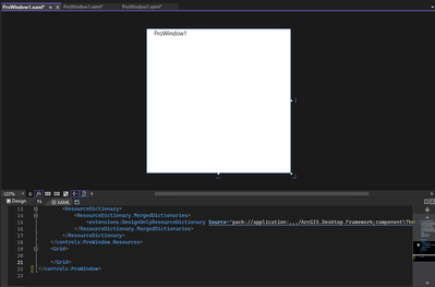

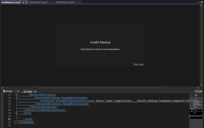

Here's something interesting...I did some crazy tests and was able to trick the system into correcting itself.
I changed controls:ProWindow to ProWindow, then right clicked on the XAML file to View Designer. The Designer finally appears, but with "Invalid Markup" (as expected due to invalid code).
I then immediately modified the XAML code back to controls:ProWindow and poof! The XAML designer was displaying/working again as expected.

i just upgraded to VS 17.6.0 and i am also not able to get the XAML Design View to show up.  i only see the XAML source view.  So i tried your trick and sure enough your fix worked for me as well.  I then closed and reopened the project and poof! - your term 😉 - the Designer View still works.  However, i had a second ProWindow control in the same VS project that still didn't work.  I suppose i have apply your magic trick on that control as well.
If i close VS, then delete the bin and obj folders, and then reopen VS, the Designer View is broken again.  I have to apply your magic trick again.
