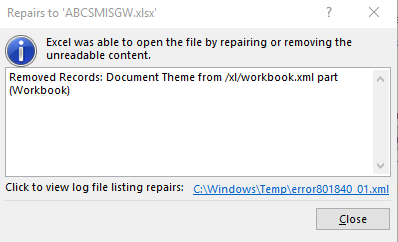

I have been using a Python/ArcPy code use to generate many Excel files (.xlsx) from shapefiles. After the last Pro update end users start complaining that they get message when they try to open those Excel files.
First, I thought it was something wrong from my end, code, server etc. but when I do the process manually. I got the same error.
When I  try to open ESRI generated Excel file I get the message below
Then I click Yes and get this message
It seems nothing get lost but it is frustrating popping multiple windows and make users think they did something wrong or something wrong with the file itself.
Is there way to fix our own or we need ESRI to fix that?
Thanks!

BUG-000132901
In ArcGIS Pro 2.6, Table to Excel with an output format of .xlsx results in a corrupt Excel table.
Fixed apparently in the 2.6.1 patch, available now

I was able to update to 2.6.1 this morning and it solved my problem.
