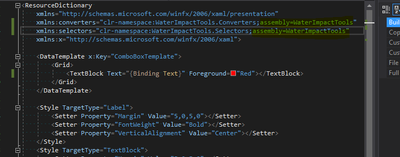

Had the same problem yesterday and was bashing my head.  However, once I opened a pane that utilized the same dictionary and a referenced IValueConverter class, errors started occurring that mentioned my resource dictionary was invalid.
I didn't realize that if your resource dictionary build action is "Resource" (vs. the default of Page), any imported namespace definitions needs to have the assembly fully qualified.  Once I added ";assembly=WaterImpactTools" to the end of the original "converters" and "selectors" imports (see highlighted lines screenshot), it started working.  I guess when Pro tries to load a resource dictionary and the dictionary fails to load, Pro doesn't say anything.  Let me know if this helps or you need any more details.

Finally the hint from ChrisSaylor helped me out to resolve the issue!
It is not mentioned in the documentation but important the set the dataTemplateFile (in my case the customCombobox.xaml) as build action to Resource
