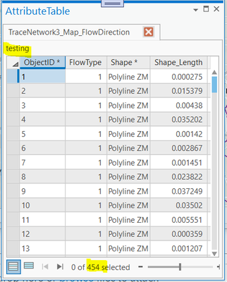

KirkKuykendall1
I modified @Wolf 's code from here, replacing this:
With this:
When I run it, I see this:

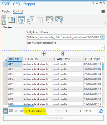

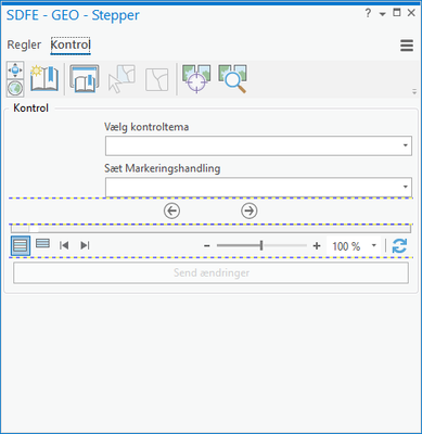

TomGeo

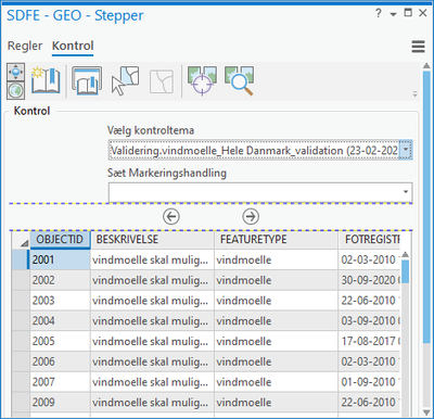

Defining the structure of the pane like this:
I get this:

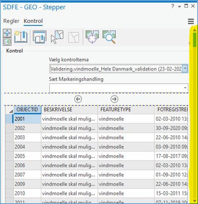

and with a loaded table it turns into this:
Where the scrollbar is not used for the table but the entire content of the pane.
As you can see, there is a good portion of things happening before the TableControl, and there is also a button below the TableControl. I have simply no idea to what component I can bind the height of the TableControl. Wrapping the TableControl into a border component, binding to the borders ActualHeight also didn't solve the issue, neither binding directly to the RowDefinition using

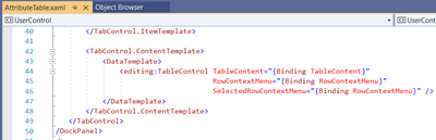

MaxHeight="{Binding ElementName=ControlGrid, Path=RowDefinitions[2].Height.Value}"

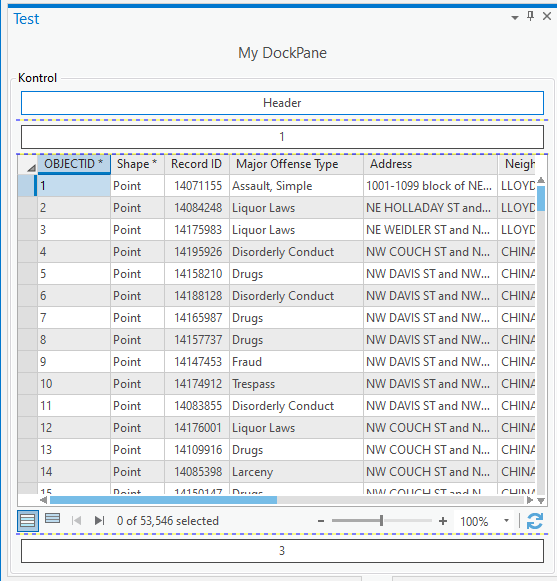

The table control gets the entire height of grid.Row = 2; which when defined as * means that it takes up the remainder of the dialog after the textblocks and buttons have taken their space.
This gives me the following UI (1st - table has no data; 2nd - table has content)

When I run the add-in i get this output, which is resizable with no problems:
As you can see the scroll bars were automatically added to the table control.  There was no need to specify Max Width/Height.   Hopefully this is working for you now as well.
